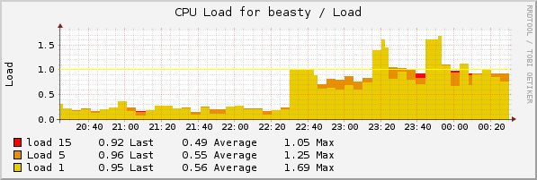

I upgraded from version 3.5.1 to 4.0.7 yesterday via the ports system on a FreeBSD 10 jail and, since then, I'm stuck with performance problems on the workers threads (this is a system load comparison of before and after the upgrade).
Load before and after upgrading to 4.0.7
I thought it might be some incompatible parameters from nagios.cfg, so I took the nagios.cfg-sample, renamed it to nagios.cfg and added only necessary parameters from my 3.5.1 config (mostly perfdata stuff), but no success..
Also, logs don't show errors.
Anyone has a hint how I should begin to debug this?

We have reports of this occurring on several systems but there does not seem to be much of a lead to follow:
http://support.nagios.com/forum/viewtop ... =7&t=27068
Currently, we're looking into it being related with a possible scheduling bug, you may also be able to alleviate this by changing your core 4 worker configuration:

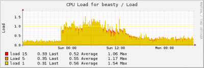

I've lowered workers from 4 to 2 and it doesn't seems to do anything for now..
One thing I haven't mention is I have a very small setup: 11 hosts with a total of 39 service checks.
I've decided to convert transport for internal checks from SSH to NRPE and it helped quite a bit but, still, I'm now averaging at 0,30 load while I was at 0,20 with core 3.5.1 and SSH transport.
So, here's a new updated graph:
- the left part is core 3.5.1 with SSH transport
- the middle part is core 4.0.7 with SSH transport
- the right part is core 4.0.7 with NRPE transport
Updated graph with NRPE transport
