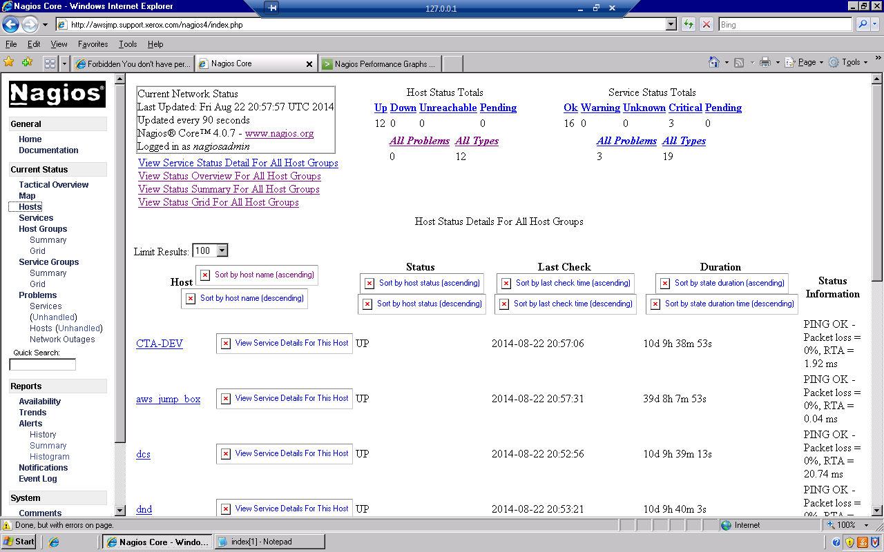

Now I think i am very close to resolution but get some other issue
I am able to open http://awsjmp.support.xerox.com/nagios4/index.php .
Data for servers/services is displaying in but i could not see anyframes or tables.Something is messing up.
Attached output for refernce
But when i try http://awsjmp.support.xerox.com/nagios4. I get
Forbidden
You don't have permission to access /nagios4/ on this server.
I can start nagios too.
Forbidden
