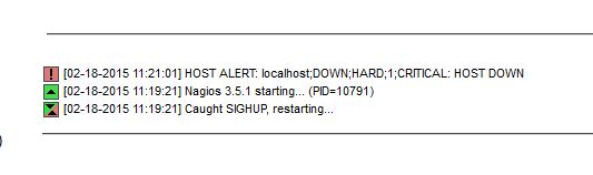

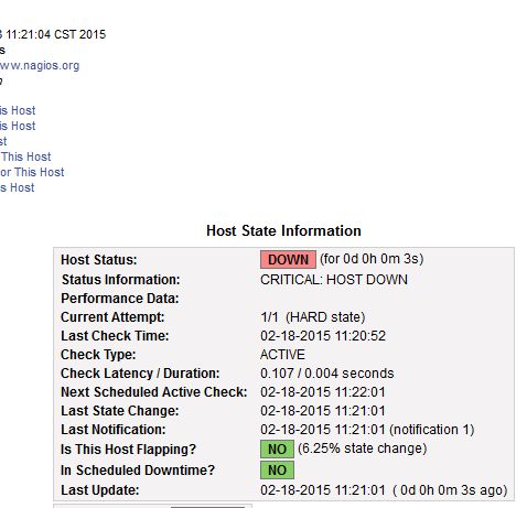

jdalrymple
Skynet Drone
Posts: 2620
Re: decrease check_ping attempts - faster email notification
Post by jdalrymple »
Have you looked at the Alert History (under Reports on the left side) to correlate the time the service goes into a hard failed state with when the alert goes out? Mine works as expected with the settings configured as I explained:
        max_check_attempts      1
        first_notification_delay        0
        check_interval          1
