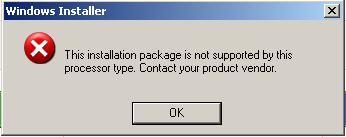

While i am trying to install NSClient++ in Windows Server 2003 R2 it shows that that this package is not compatible with this server.
Is there any other way to integrate windows server 2003 with nagios? So that i can get normal services like NSClient++ does offer:
For your information, Windows 2012 R2, Windows 7 & other servers are working fine.

Are you are trying to install the 64 bit version of the NSClient++ on 32 bit Windows Server?
Try installing the 32 bit version of NSClient++ instead.

I dont know suddenly becomes ok after consulting with a Nagios expert. :x :x :x
As far i remember before i had tried using 32/64 bit client & it did't work. But today i have tried it again & its working well. Strange!!!!!!
Anyway, Thanks a lot! :D :D :D :D

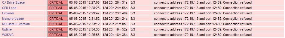

A little update. Just now i have tried with one of my windows server using 32/64 Bit. Its not working. Have a look on the bellow error. Translation is i need to install a specific service pack package for this.
Its little bit depressing. For linux host there is nothing to do. So, for Windows why its becoming necessary to configure in client end? Is it possible to configure in Nagios end without anything configuring in Windows(Client) side? Same what we do for Linux Host!
It will ease a lots of hard work. Expecting your kind help!
Regards
Sazzad

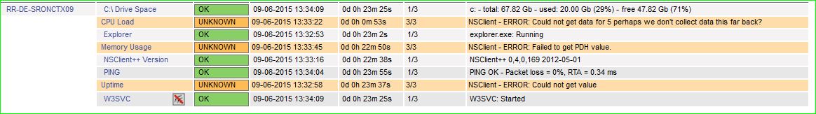

I have tried NSCLIENT-0.4.2.88 version & worked for 4 Windows server. After that for few server i have tried NSCLIENT-0.4.0.169 version & it works!
But for two server(Windows 2000) facing strange problem:
Please note that same version of NSCLIENT++(NSCLIENT-0.4.0.169) is working for windows 2003 Server. So, i guess its happening due to OS platform.
Any idea or should i try older versions?

Re: Can't integrate NSClient++ with Windows Server 2003 R2
On the failing server, try rebuilding windows performance counters:
cd\windows\system32
lodctr /R
then restart the NSClient++ service.
Let us know if this fixed your issue. Thanks!
