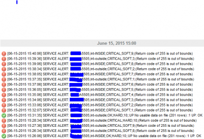

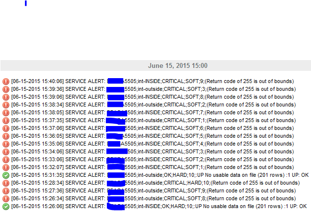

We are getting the following under the "alert history".
We are monitoring ASA 5505 firewall. We checked manually that interfaces are up and not flappping. However nagios reports the following.. i.e screeshot attached.
When i attempt to check interfaces via command line, i get this.

CRITICAL;SOFT;9;(Return code of 255 is out of bounds)

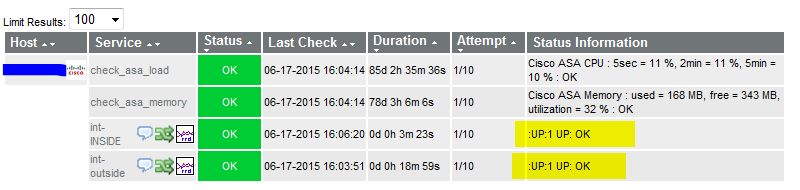

It seems options -Y -e -k were causing the issue. Nagios showed the following when i didn't include these options (or lease one by one) as below. Without these option, nagios is show interfaces as :UP: 1 UP: OK
