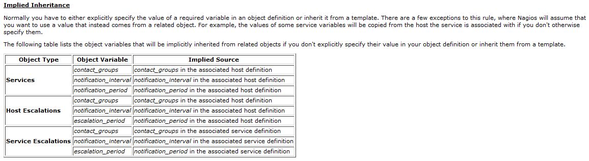

Can you look at host templates to see if there are any 60s defined either at the host or upstream templates?

Apologies for the late reply - I've been going through a whole world of pain trying to carry out a silent install for NSClient++
I'll try to get back to this later today and let you know if I find anything, although the fact that 10, 15, 20 etc intervals work fine would suggest that the value isn't being inherited from elsewhere...

Re: Notification_Interval query
It's very possible. Read about implied inheritance very carefully.
Not really sure why, but this nagios has suddenly started behaving itself, only sending the first notification when notification_interval is set to zero.
This thread can now be closed, but thank you for the valuable pointers to the material on inheritance!
