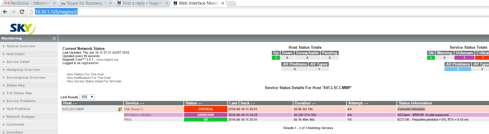

the report show a grey status.
What output / error message is produced ?

the result I show it below and Attach the nsclient.ini with the password =
Can you show us what you mean by a 'grey' status? What is the error message?
