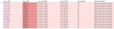

i have added new server in nagios and when i run service nagios restart its working good with no issue but in the nagios gui and i see this error message

Here are the error message i am getting as per screen shot
