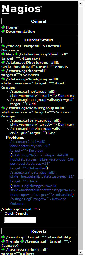

I've installed Nagios 4.3.2 on an Ubuntu 16 server but I have a problem with the display of the menu with the side.php file. Instead of displaying the menu, its displaying the raw html. As a test, I've also installed Nagios on an Ubuntu 14 server and it seems to display just fine. Has anyone seen this before? Any insight at all would be greatly appreciated. I'm uploading a screenshot of the left-side menu.
Thanks;
Frank

Yes, this is most likely a php issue. Please post the result of:
php --version-

I followed the step by step from here and it worked successfully.
What I realized was if I was missing the following package I got the same results as you...
Run the following:
And restart apache2 and you should be set!
Run the following:
apt-get install libapache2-mod-php7.0Re: side.php does not display properly on Ubuntu16
Yep, that was it. I can't thank you enough.
