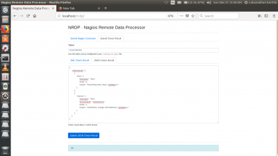

I have NRDP configured with Nagios core. Passive host and service checks are not getting processed by NRDP. I don't see them in nagios.cmd nor in nagios.log, no errors while submitting from http://localhost/nrdp
But, the downtime requests are getting processed and i'm seeing them in the nagios.cmd file. What could be missing?

That's the thing here. No errors. Just a OK at the bottom and that too disappears soon,

If i submit the command, it's not showing any output, just a blank page. Any thoughts?

Trying sending a check with something like this against, on a host/service you have for passive checks.
Once you submit it with this format, try a tail and see if it worked.
Here's my example.
Let us know!
https://github.com/NagiosEnterprises/nrdp/pull/30
You could use the pull request, or just don't use the default JSON format which is fine too.
"checkresults": [
"checkresult": {
"type": "host",
"checktype": "1"
"hostname": "localhost",
"state": "0",
"output": "Everything looks okay! | perfdata=1;"
"checkresult": {
"type": "service",
"checktype": "1"
"servicename": "SSH",
"state": "1",
"output": "WARNING: Danger Will Robinson! | perfdata=1;"
tail -10 /usr/local/nagios/var/nagios.log
[1515014710] PASSIVE SERVICE CHECK: localhost;SSH;1;WARNING: Danger Will Robinson!
[1515014710] SERVICE ALERT: localhost;SSH;WARNING;SOFT;1;WARNING: Danger Will Robinson!
[1515014710] PASSIVE HOST CHECK: localhost;0;Everything looks okay! Test!
