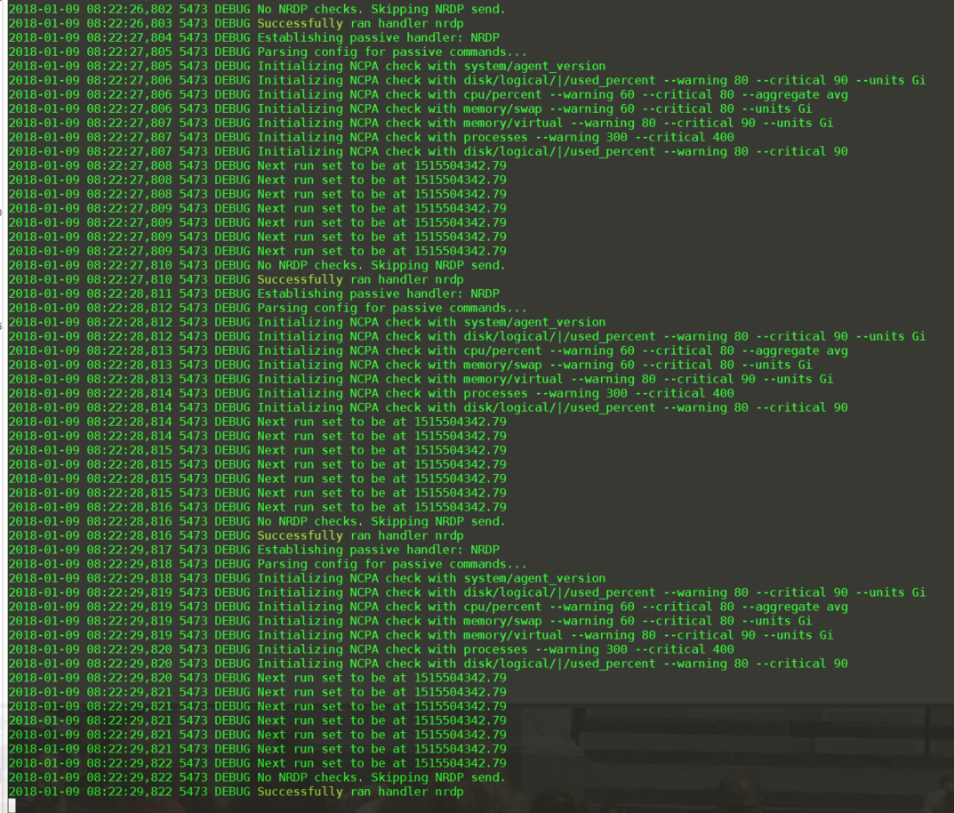

I took a look at the ncpa_passive.log file and for some reason, it looks like the NCPA agent is running the checks every second and not every 300 seconds like it should.

I took a look at the code and I think when debugging is turned on, it is logging every second.
