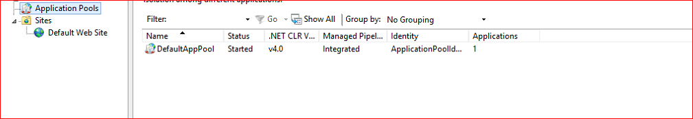

Scott
Yes my IIS is setup with just Default Web Site
See attached
Perfmon
Perfmon
IIS
