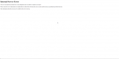

I actually worked through all the errors today and ran the config test. All looks good now (see screenshot). I was even able to reload the nagios config and start the service. However, i'm no longer able to reach the web console after logging in. I confirmed the Apache HTTP server and service is running. Any ideas to help resolve? See second screenshot for error.
Posts: 13587
1. Make sure selinux is disabled (not running).
sestatus
2. Clear cookies and the browser cache.
3. Verify the ip address by running in terminal:
ip addr
4. Try accessing the web UI by typing the following in the browser's address bar:
http://x.x.x.x/nagios
where you substitute the x.x.x.x with the actual IP address of your nagios server.
mtripodi
Posts: 61
Post by mtripodi »
Thanks, I have done all those steps, rebooted the server and continue to receive the same message after logging in. Any other ideas? I really need this working soon.
