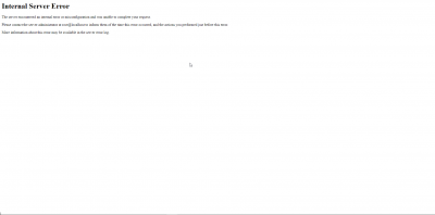

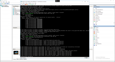

I disabled the firewall, noticed Nagios wasn't started automatically after reboot so I ran a command to set that. Confirmed both Nagios and httpd service are currently running. See attached imaged.
I can reach the test page when entering 172.19.1.7 with the /nagios at the end.
It was working initially, I ran through some of the configuration I copied over and resolved the errors. Once they were all corrected, I tried hitting the webpage again and ran into that message.

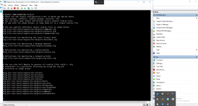

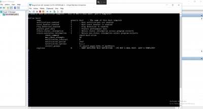

I was able to edit the nagios.cfg file by adding the directories containing the configuration I copied over. Confirmed Nagios test server is now looking at all my files. However, now when I run the config test command i'm getting a "invalid max_check_attempts value for host" error. I confirmed each host is pointing to an existing template that Nagios should see and that those templates (generic-host and generic-service) have this value set. So i'm not sure why it keeps complaining. See attached screenshot.

Yes, I understand what your saying. However, all the same configuration is working on my production server. Something must have been changed recently when moving around files to correct errors. I have attached 4 files: host template, service template, hostgroups, and nagios.cfg file.
I have edited the nagios.cfg file to point to the directories containing my config files. Nothing has changed so i'm confused as to why those host files are complaining about not seeing the max_attempts value when they are in the templates associated.
