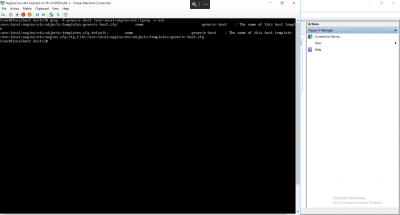

Ok then i'm out of ideas. The obvious issue is that my host definitions are not seeing both the generic-host and generic-service templates which contain the max_check_attempts value. I have no idea why! Confirmed Nagios is looking at this directory: /usr/local/nagios/etc/objects/templates
I have attached screenshots of the output from the commands you suggested. Looks like generic-host template is only associated with 2 directories, the original templates.cfg I renamed to templates.cfg.default so Nagios would not look at it and only look at the above (my directory).
I'm not sure why it's complaining when everything is there and defined. I need to proceed with my testing ASAP.

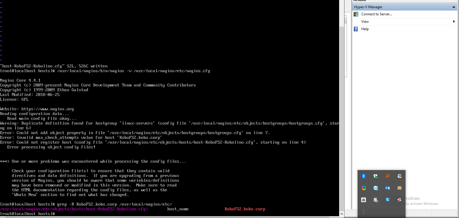

I then ran the config test after making all the changes and now see 28 errors! Most appear to be missing service check commands and a host check command. I'm unable to see all the errors as I can't scroll up the window further or export.
I'm not sure what change caused all these errors but we seem to have backtracked instead of making progress :(
Please HELP! I have attached a screenshot.

It looks like pretty much all of the errors you have now come from missing commands. Do you have a commands.cfg file with all those commands in it that you can copy those commands out of into your new one? If you copy the ones you can see now, you can then see the rest of the output.
You can also scroll over that by doing this after you run the Nagios Core config verification:
 | less
