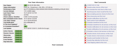

I have do this but not success. Please find the attached scrrenshot.
Thanks and Regards,
Akshay Kaushik
Re: Event Acknowledgement in Nagios Core
I don't understand, you will not see the ability to acknowledge a host if it is in an UP state.
