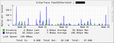

1. Currently the graph is listing in bytes as opposed to kb which I'm looking for (as attached).
2. Is it possible to also add the 'Link Speed' as per the image attached? In fact, i'm pretty much looking for this exact tomeplate lol.
This is the existing template i want to change..

./check_snmp_int.pl -H localhost -C public -B -M -k -f -Y -n wlan0 -w 200,400 -c 0,600
running from terminal runs as expected and displays in nagios fine. I actually had to include the -f flag to output the perf data for PNP4nagios and then added the -B and -M to have it calculate in MBps.
So, i think the PNP4nagios template is what needs tweaking.
NagiosN00b
Posts: 8
Joined: Wed Jan 31, 2018 7:24 am
Re: PNP4Nagios Template for Check_SNMP_int
Post by NagiosN00b »
This is what it currently looks like in my PNP4Nagios but i would like it tweaked to look like the image in my initial request with 'Link speed' and the 'Total in' and 'Total Out' details..
