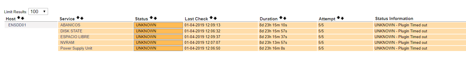

Hi guys,
I really need a big help on this, my environment:
Nagios 4.2.4
CentOS Linux release 7.6.1810 (Core)
I'm trying to monitor a EMC Data Domain using check_dd.pl plugin, and I get the following error: UNKNOWN : Plugin Timed Out
I made some testing from terminal, and I get these:
[root@ensnagios01-intra-temporal]# /bin/perl ./check_datadomain.pl -H 10.200.8.21 -v DISKUSED -C NAGIOS
CRITICAL:No response from remote host "10.200.8.21" for .1.3.6.1.4.1.19746.1.3.2.1.1 with snmp version 1
[root@ensnagios01-intra-temporal]# /bin/perl ./check_datadomain.pl -H 10.200.8.21 -v DISKUSED -C NAGIOS -P 2
CRITICAL:No response from remote host "10.200.8.21" for .1.3.6.1.4.1.19746.1.3.2.1.1 with snmp version 2
[root@ensnagios01-intra-temporal]# /bin/perl ./check_datadomain.pl -H 10.200.8.21 -v DISKUSED -C NAGIOS -P 3
Any idea on how solving this situation?
