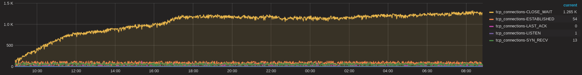

Connections status
Connections status
Posts: 9190
Re: NSCA 2.9 client problem
No, Increasing the open files limits is what I would of suggested.
Let us know if this helps.

nsca_uk 30492 nagios 7903u  IPv4         1665247740      0t0        TCP server:5660->li1417-217.members.linode.com:54132 (CLOSE_WAIT)
nsca_uk 30492 nagios 7904u  IPv4         1665248200      0t0        TCP server:5660->li1414-52.members.linode.com:34966 (CLOSE_WAIT)
Here are huge amount of sock and IPv4 type. I think, sock type is wrong holded files handlers and it seems, that IPv4 too. IPv4 type is in state CloseWait, which i can see in graph (see attachment).
Let see, what happen to tomorrow, but i afraid, that situation not change and NSCA hang on opened files limit.
If you have any another idea or tihngs to check, please, let me know.
Thank you for your effort.
Connections state
Connections state

When you check the NSCA server, are the stuck connections coming from a few servers or many servers?

As i expected, today NSCA hang again on same problem:
[root@server ~]$ service nsca_uk status
Redirecting to /bin/systemctl status nsca_uk.service
● nsca_uk.service - NSCA for de cluster
   Loaded: loaded (/etc/systemd/system/nsca_uk.service; enabled; vendor preset: disabled)
   Active: active (running) since Št 2019-05-09 06:44:17 UTC; 2 days ago
 Main PID: 30492 (nsca_uk)
   CGroup: /system.slice/nsca_uk.service
           └─30492 /usr/sbin/nsca_uk -c /etc/nagios/nsca_uk.cfg
may 09 06:44:17 server systemd[1]: Starting NSCA for de cluster...
may 09 06:44:17 server nsca[30492]: Starting up daemon
may 09 06:44:17 server systemd[1]: Started NSCA for de cluster.
may 11 01:29:11 server nsca[30492]: Network server accept failure (24: Too many open files)
[root@server ~]$ lsof -a -p 30492 | wc -l
15764
COMMAND   PID   USER   FD   TYPE             DEVICE SIZE/OFF       NODE NAME
nsca_uk 30492 nagios  cwd    DIR                8,0     4096          2 /
nsca_uk 30492 nagios  rtd    DIR                8,0     4096          2 /
nsca_uk 30492 nagios  txt    REG                8,0    51464      31798 /usr/sbin/nsca
nsca_uk 30492 nagios  mem    REG                8,0    61624       4665 /usr/lib64/libnss_files-2.17.so
nsca_uk 30492 nagios  mem    REG                8,0  2151672       4647 /usr/lib64/libc-2.17.so
nsca_uk 30492 nagios  mem    REG                8,0   115848       4657 /usr/lib64/libnsl-2.17.so
nsca_uk 30492 nagios  mem    REG                8,0   187952      31794 /usr/lib64/libmcrypt.so.4.4.8
nsca_uk 30492 nagios  mem    REG                8,0   163400       4640 /usr/lib64/ld-2.17.so
nsca_uk 30492 nagios    0r   CHR                1,3      0t0       1061 /dev/null
nsca_uk 30492 nagios    1w   CHR                1,3      0t0       1061 /dev/null
nsca_uk 30492 nagios    2w   CHR                1,3      0t0       1061 /dev/null
nsca_uk 30492 nagios    3u  unix 0x000000007063482c      0t0 1599797206 socket
nsca_uk 30492 nagios    5u  sock                0,9      0t0 1599814373 protocol: TCP
nsca_uk 30492 nagios    6u  sock                0,9      0t0 1599802987 protocol: TCP
nsca_uk 30492 nagios    7u  sock                0,9      0t0 1599885192 protocol: TCP
nsca_uk 30492 nagios    8u  sock                0,9      0t0 1599800045 protocol: TCP
nsca_uk 30492 nagios    9u  sock                0,9      0t0 1599890841 protocol: TCP
nsca_uk 30492 nagios   10u  sock                0,9      0t0 1599984874 protocol: TCP
nsca_uk 30492 nagios   11u  sock                0,9      0t0 1599994314 protocol: TCP
nsca_uk 30492 nagios   12u  sock                0,9      0t0 1600026625 protocol: TCP
I can see only few IPv4 type handler, but huge amount of sock type handler. This problem occured only when at last one client have NSCA v2.9.
Meantime my colleague attempt another solution, fork from NSCA and looks very usable (NSCA-NG). Actually here is sending about 200 servers their notifications and no problem spoted. I know, that this product isnt in your portfolio.
Many thanks for your effort, please, consider this case as solved and lock this topic. As a solution for us it seems is better NSCA-NG, like newer version of NSCA.
Best regards.
