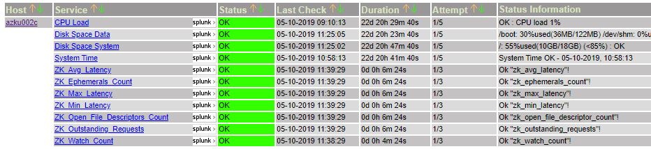

I dont think so this would be an issued but I have commented out it just for safe side.
/etc/nagios/objects/commands.cfg:   command_name    check_zookeeper
/etc/nagios/objects/commands.cfg:   command_line    $USER1$/check_plugin.pl $USER1$/check_zookeeper.pl -H $HOSTADDRESS$ -P 4150
I have also modified /etc/group as you directed and also attached new info.txt.
info.txt
(220.01 KiB) Downloaded 461 times
Re: Zookeeper script throwing an error
I think I found what the issue is.
The file was opened with a editor that added carriage returns in the script and that is causing the error.
Install an application on the Nagios server called dos2unix and then run the following to remove them.
dos2unix /usr/lib/nagios/plugins/check_zookeeper_apache.py
Test the plugin and let us know if it works.

This is a Gentoo server and have some issue with repository. We cant take any risk to install and break the box. Is there any alternate to fix the script?
shamrozkadiwal
Posts: 74
Joined: Thu Jan 25, 2018 1:13 am
Post by shamrozkadiwal »
I ran this command instead of installing dos2unix.
# cat check_zookeeper_apache.py | tr -d '\015' > ./check_zookeeper_apache_new.py
It looks like removing the characters made the plugin work for you.
Let us know if you have any further questions or that we can lock the post.
