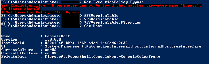

Re: CHECK_WINDOWS_UPDATES - NRPE ERROR
Thanks for the quick reply. I replaced the nsclient.ini file with the one you gave me, but was unable to set the execution policy to Bypass. I think this particular server is running PowerShell version 1, which might explain that, but I can't be sure. I've attached a screenshot of the results and, in its place, thought I'd try running the command, "Set-ExecutionPolicy Unrestricted" and restarted the NSClient++ (x64) service. Then, I ran the command you gave me on the Nagios server, which returned the following results:

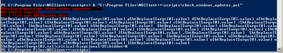

@fodmidoid, Can you check if you're able to manually execute the check_windows_updates.ps1 script from the PowerShell terminal? Also, please upload the nsclient.log file.
Here are the result of running it locally in PowerShell, as well as the nsclient.log file. Thanks.

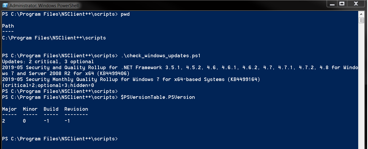

@fodmidoid, Looks like Power Shell 1 is not compatible with this particular plugin you chose. Here's the output from my server:
I suggest looking for non powershell plugin on the exchange portal.

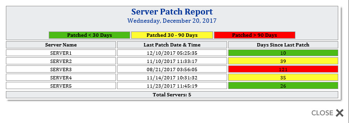

I found a PowerShell script someone had posted on the web (link below), which checks all servers from a text file and produces a report that shows the last date and time each server was patched, and how many days have passed since the last patch. The report is then emailed in html format and color-coded, based on severity.
I'm wondering if there's a way to incorporate this into Nagios? I would much rather be notified a warning (yellow) if servers haven't been patched in over 30 days, and a critical alert (red) if they haven't been patched in over 90 days.
The script and screenshot are attached and here is the link to the original share:
https://community.spiceworks.com/script ... tch-report
Again, any help is greatly appreciated. Thank you very much.
Server Patch Report.txt- (10.46 KiB) Downloaded 617 times
