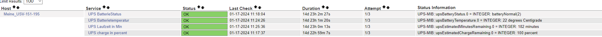

Hello!
I have an Online UPS with snmp module.
I have added the Host and a Service successfully and can get all data with snmpwalk:
root@nagivis:~# snmpwalk -v3 -u (user)-m /usr/share/snmp/mibs/UPS-MIB.txt 192.168.151.195 1.3.6.1.2.1.33.1.2.1
UPS-MIB::upsBatteryStatus.0 = INTEGER: batteryNormal(2)
In the webgui the status of the service is ok, but the "Status Information" states jsut (No output on stdout) stderr: Configuration directives understood:
The command is:
command_name check_ups_battery
command_line /usr/bin/snmpwalk -v3 -m /usr/share/snmp/mibs/UPS-MIB.txt -H 192.168.151.195 -u (user) -t 360 iso.1.3.6.1.2.1.33.1.2.1
I found in the web that nagios cand translate the output of the content of the status infos and i have to use a plugin like SNMPTT.
I followed the original guide: http://www.snmptt.org/docs/snmptt.shtml#Nagios-Netsaint
but im a little clueless at the part where you Create an EXEC statement such as the following for each EVENT entry in the snmptt.conf file like this:
EXEC /usr/local/nagios/libexec/eventhandlers/submit_check_result $r TRAP 1 "xxxxxx"
In the example they used somethink like what you could get from the snmpwalk: "Drive $1 in bay $2 has failed".
My gut tells me to use for me"batteryNormal"
Im rather helpless with the part after this where do i get the variables - the mib file?
do i have to use any variables?
I want to add those 4:
root@nagivis:~# snmpwalk -v3 -u (user) -m /usr/share/snmp/mibs/UPS-MIB.txt 192.168.151.195 1.3.6.1.2.1.33.1.2.1
root@nagivis:~# snmpwalk -v3 -u (user) -m /usr/share/snmp/mibs/UPS-MIB.txt 192.168.151.195 1.3.6.1.2.1.33.1.2.3
UPS-MIB::upsEstimatedMinutesRemaining.0 = INTEGER: 999 minutes
root@nagivis:~# snmpwalk -v3 -u (user) -m /usr/share/snmp/mibs/UPS-MIB.txt 192.168.151.195 1.3.6.1.2.1.33.1.2.4
UPS-MIB::upsEstimatedChargeRemaining.0 = INTEGER: 100 percent
root@nagivis:~# snmpwalk -v3 -u (user) -m /usr/share/snmp/mibs/UPS-MIB.txt 192.168.151.195 1.3.6.1.2.1.33.1.2.7
UPS-MIB::upsBatteryTemperature.0 = INTEGER: 16 degrees Centigrade
Im not an linux/nagios pro so could you give me a hint how i can configure the Nagios correct?
I would really appreciate it.
Thank you in advance!

I have the solution:
ny command was :
command_line /usr/bin/snmpwalk -v3 -H 192.168.151.195 -u nagios -t 360 iso.3.6.1.2.1.2.1.0
and i had to remove the -H
now everything is fine:
bbahn
Posts: 380
Joined: Thu Jan 12, 2023 5:42 pm
Re: snmpttconvertmib and ups monitoring
Post by bbahn »
@madadmin,
Yes, /usr/bin/snmpwalk does not take a -H parameter and instead are formatted like this:
snmpwalk [options] [community string/authentification information] [host name/address] [OID]
I believe you may have been confusing the syntax for /usr/bin/snmpwalk with the Nagios plugin /usr/local/nagios/libexec/check_snmp, which has the following syntax:
 check_snmp -H <ip_address> -o <OID> [-w warn_range] [-c crit_range]
    [-C community] [-s string] [-r regex] [-R regexi] [-t timeout] [-e retries]
    [-l label] [-u units] [-p port-number] [-d delimiter] [-D output-delimiter]
    [-m miblist] [-P snmp version] [-N context] [-L seclevel] [-U secname]
    [-a authproto] [-A authpasswd] [-x privproto] [-X privpasswd] [--strict]
If you do want to use Nagios's check_snmp plugin, you can find more documentation here: https://nagios-plugins.org/doc/man/check_snmp.html
