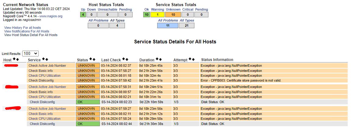

Re: Trouble with User Host Profile for IBMi Nagios plugin
Is there anybody who knows how host user profiles are working and what the connection is with the hostname or IP addresses working with the IBMi plugin for Nagios.
And YES I have the standard explanations found on the WWW. It's also not clear how to add parameters to these commands.
I'm using the Nagios core module with the IBMi plugin correctly installed on a Linux server runniing on powersystem.

All other services aren't working at all, giving a java error.
Exception - java.lang.NullPointerException.
Al definitions are the same as the firts definition which is working okay.

When running the command directly from the commandline it al works perfectly
eg.
/bin/bash /usr/local/nagios/libexec/check_ibmi_status.sh -M BasicInfo -H <hostname>
Gives me the versionnumber of the systemsoftware running on that machine.
See attachment.
