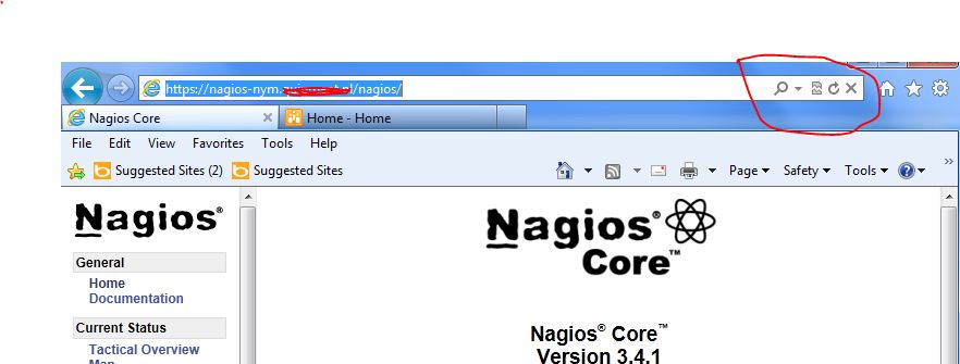

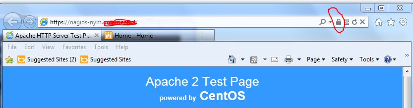

2. Pls find the attchment for working SSL with yellow Lock and non working SSL only for NAGIOS.
Also I have noted that when I browse NAGIOS the SSL Lock shows for some seconds and suddenly disappers as soon as nagios loaded completly .

SSL not working for nagios
SSL working
SSL working
