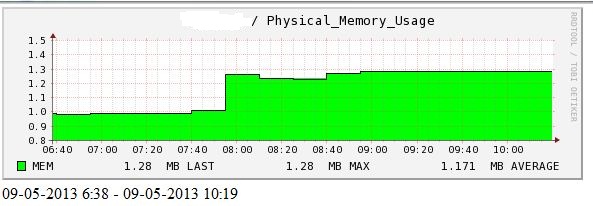

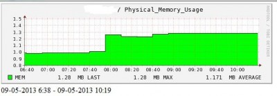

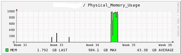

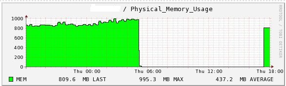

I am facing problem in PNP graph for Physical memory usage. The server is having a 2GB of physical memory and its utilization varies between 650 MB to 1.5 GB. The default PNP template displays the unit for last received performance data and hence the graphs are plotted wrongly in PNP. I have attached the screenshots for your reference. please help me in fixing this issue.
Example scenario:
in 1 st polling The performance data passed is 768 MB, in 2nd polling it is 859 MB and in 3rd it is 946 MB. so the graph will be plotted with these value and unit will be MB. But in the 4th polling,5th polling and so on the usage goes beyond 1 GB and in this case the unit is converted to GB and the maximum value is displaying as 946 GB instead of 1.xx GB.
Please help me in getting a PNP template that can understand this differnce and dispaly graphs correctly or help me doing the chnages that i need to do to achieve proper graphs.

Re: unit converstion problem in PNP graphs
