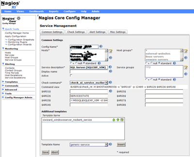

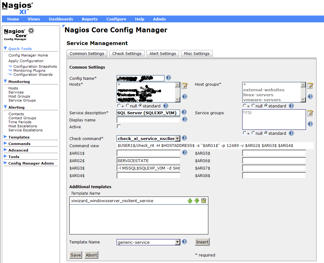

I added service monitoring by using the wizard:

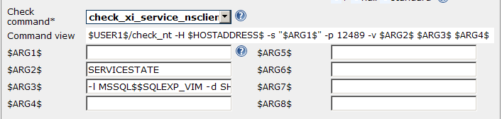

Changed the line to the double $$
check_xi_service_nsclient
$USER1$/check_nt -H $HOSTADDRESS$ -s "$ARG1$" -p 12489 -v $ARG2$ $ARG3$ $ARG4$
$ARG1$
$ARG2$ SERVICESTATE
$ARG3$ -l MSSQL$$SQLEXP_VIM -d SHOWALL
Command submitted for processing...
Waiting for configuration verification.......
Configuration verification failed.
Success! Nagios Core was restarted with an updated configuration.
View configuration snapshots
An error occurred while attempting to apply your configuration to Nagios Core. Monitoring engine configuration files have been rolled back to their last known good checkpoint.
In the log file:
Warning: Service 'SQL Server (SQLEXP_VIM)' on host 'SERVER.FQDN.dns' has no check time period defined!
Error: The description string for service 'SQL Server (SQLEXP_VIM)' on host 'SERVER.FQDN.dns' contains one or more illegal characters.
Total Errors: 1
***> One or more problems was encountered while running the pre-flight check...

If I replace the $$ with \$ in the web interface of Nagios core config, I receive also an error.
As an user, I entered the correct service name in the wizard. If there is any escaping code(s) needed, the web interface should translate this to correct commands. What to change to make this work ?
