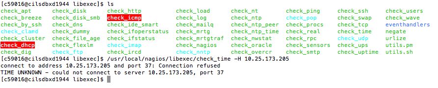

rockxd - sorry, I'm not sure I know what error you're talking about. What is the output if you run check_ntp from the command line?
If you're still having the "no response from server" error I would inquire with your network team about whether or not they let NTP queries out of the network.

I am in libexec but that command is not working. It doesn't appear that check_ntp is located in my libexec.

rockxd - your machine doesn't need to have ntp.conf at all for check_ntp to work. I was just trying to use ntpdate as a connectivity troubleshooting tool since telnet doesn't really work in this case. We could use nmap if you have it installed on the server:
Also, I pulled up a screenshot from your old check_time thread and it appears that check_ntp is there. Why would it have been removed?
