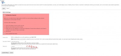

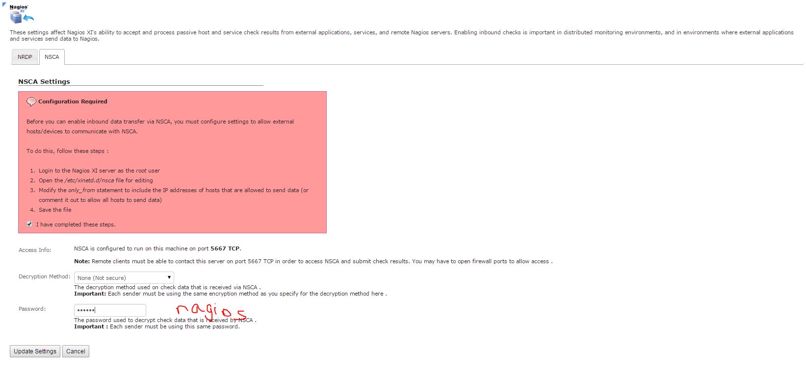

Nagios Web Config
Below is the config

Nagios Web Config

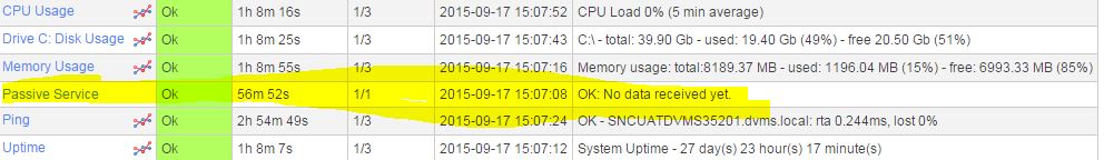

Is there anything pending in capturing these events. I don't see any in "Unconfigured Objects"

I don't see anything in Unconfigured Objects or anything related in the NagiosXI. Can you hep me on how to setup from the front end of what we see in the log?
This is basically tracking iisreset from command line will generate 3201 and 3202 and I don't see anything showing up related.
