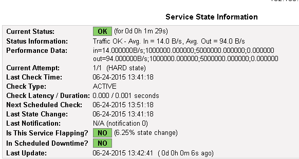

Ok, i enabled the switch monitoring and the bandwidth interfaces. this is the performance data of port 3 bandwidth, it can be monitoring by nagiosgraph?, like the grap of mrtg?

See the values for the "Performance Data" row? It looks like you have valid performance data, so you should be ok to implement nagiosgraph or pnp4nagios (I prefer pnp4nagios).
