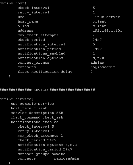

There is something:
host and service configuration

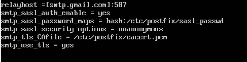

main.cf of postfix
main.cf of postfix

Jul  7 14:50:18 ubuntu postfix/smtp[2157]: warning: database /etc/postfix/sasl_passwd.db is older than source file /etc/postfix/sasl_passwd
Jul  7 14:50:21 ubuntu postfix/smtp[2157]: 4793315FCB2: to=<[email protected]>, relay=smtp.gmail.com[173.194.64.109]:587, delay=2.8, delays=0.03/0.02/1.7/1, dsn=2$
Jul  7 14:50:21 ubuntu postfix/qmgr[1074]: 4793315FCB2: removed
What was it you did that worked? I'm still thinking this is likely a mail server setup issue - not a Nagios issue.

We need to see your notification commands, notify-host-by-email and notify-service-by-email.
