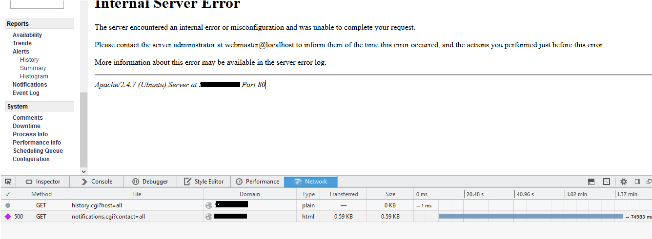

If you're using Firefox/Chrome do you see anything in the "Network" section of the Developer Tools/Firebug console? (F12)

Re: Reports section on side bar
this was the output
