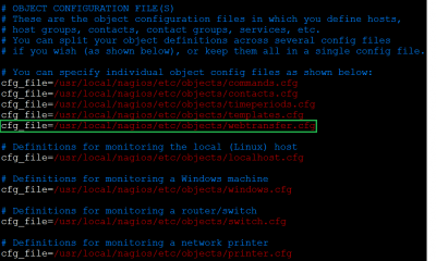

Okay...I finally got some results in dashboard!
I eventually found that I needed to go into nagios.cfg, and reference the new host file I created in the objects folder, WEBTRANSFER.CFG:
nagios.cfg-webtransfer

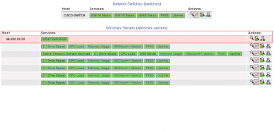

So that made it show up in the dashboard, but now it's showing the host as being down and I'm not getting notifications for the service check (after purposefully changing the password to something incorrect). Is it because I have it set as a windows host? Is there something else should be doing?
Also, since the machine isn't on my network, I don't want to check the host's availability, I only want to check this one service and have it all be green, instead of pink. Can you help me cross the finish line?

The reason I initially told you to put the .cfg file in the /servers/ folder is because you won't have to edit the nagios.cfg (it automatically includes configs in the /servers/ folder).
cfg_dir=/usr/local/nagios/etc/servers
The check that's failing now is a ping check, can you try to ping the address from your Nagios machine and post the result?

Yeah, exactly. The problem is that this is not a pingable host. Pings are disabled so I would like to exclude any host checks and just monitor the share autherntication with check_smb_share_AA.
And then, I need to have notification working correctly for that particular thing.
Otherwise, this is nearly done! Thanks.

For this, add we'll need to create a dummy command.
Add this to your commands.cfg -
# 'check_dummy' command definition
command_name    check_dummy
command_line    $USER1$/check_dummy 0
Now open the host / service file you just created and look for -
define host {
        use                             linux-server
        host_name                       <host>
        alias                           <host alias>
        address                         <ip address of server>
        max_check_attempts              5
        notification_interval           30
After address <ip address of server>
Add check_command check_dummy
Example -

Okay...status is up! Thank you.
Now, I just need to get the notifications working correctly. I changed the password in the cfg file I created, and managed to get a notification that it was critical, but it didn't send a recovery email.
Re: Need Plugin Recommendation For Monitoring Shared Folder
Posted: Mon Dec 14, 2015 11:01 am
by Jacktivated
I managed to get the recovery emails working, so it looks as if this plugin is successfully installed and effectively monitoring our password protected inter-network share for credential expiration.
