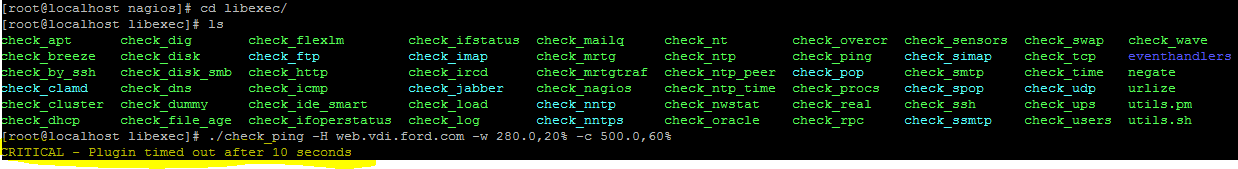

Hi ,
i am getting Error CRITICAL - Plugin timed out after 10 seconds. check_ping plugin already their in nagios server.

rhassing wrote:What happens if you try the plugin on the commandline?
check_ping -H web.vdi.ford.com -w 280.0,20% -c 500.0,60%
Or even if you try to ping the host:
ping web.vdi.ford.com
please find the below attached add screen shot.

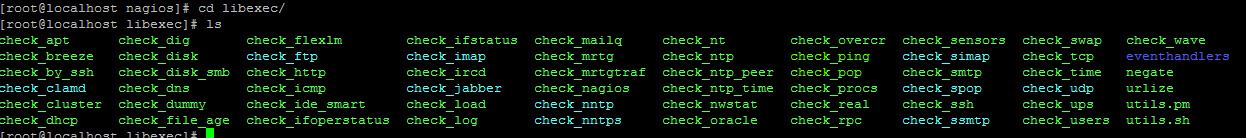

Please go to the libexec directory, where you did do the ls command and do:
./check_ping -H web.vdi.ford.com -w 280.0,20% -c 500.0,60%

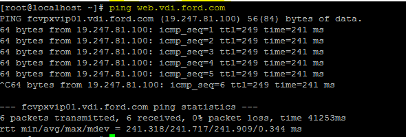

Hi ,
normal Ping command its working fine. when i am trying to run following command ./check_ping -H web.vdi.ford.com -w 280.0,20% -c 500.0,60% i am getting error CRITICAL - Plugin timed out after 10 seconds. please find the attached screen shot.

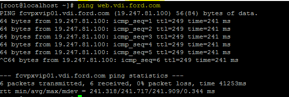

Hi ,

Can you try to use the check_ping command to check fcvpxvip01.vdi.ford.com? It looks like that's what your ping command is resolving to.
