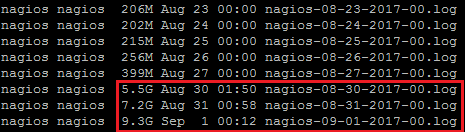

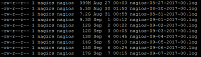

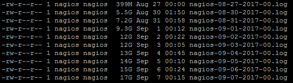

- last 3 day logs
- Nagios log sizes.PNG (6.58 KiB) Viewed 6218 times
Re: Nagios Freezes and Host Status not getting Updated
I wanted to see the status.dat file so I can check what the server thinks the current status is and the status of that services that are not running correctly.
I thing the freezing is caused by Nagios having to process the very large nagios.log file and we would have to look in that file to see that has caused it to increase in size.
Hi tgriep,
The log rotation is not working i guess because i see the nagios logs keep growing everyday.Could you please help me to find the issue. Thank you!
