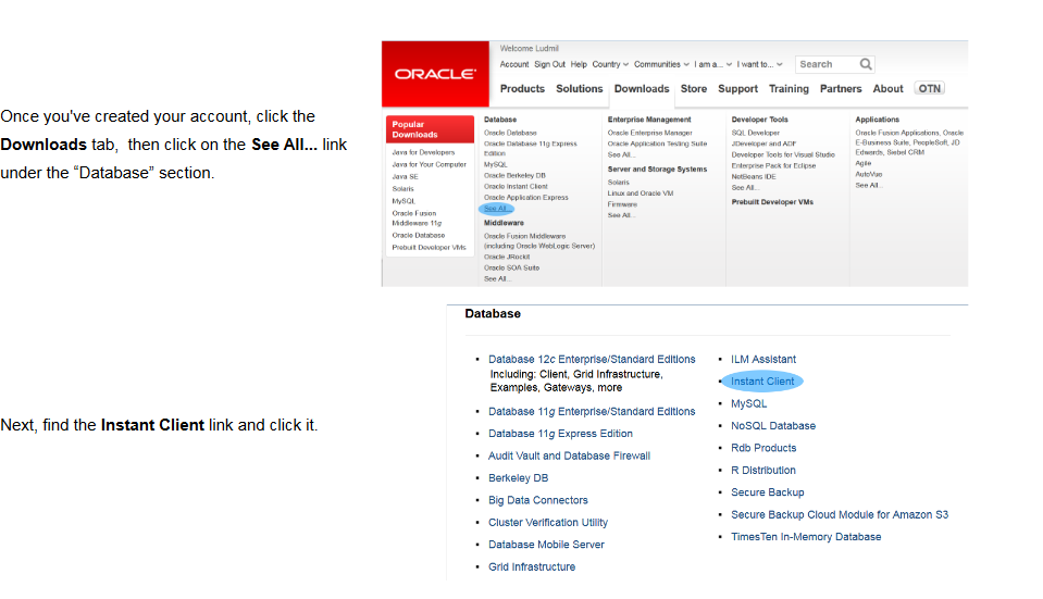

Due to legal reasons, Nagios cannot provide direct download links to these RPMs so you will have to go to Oracle's website and download them. Navigate to http://www.oracle.com/
and create an account.

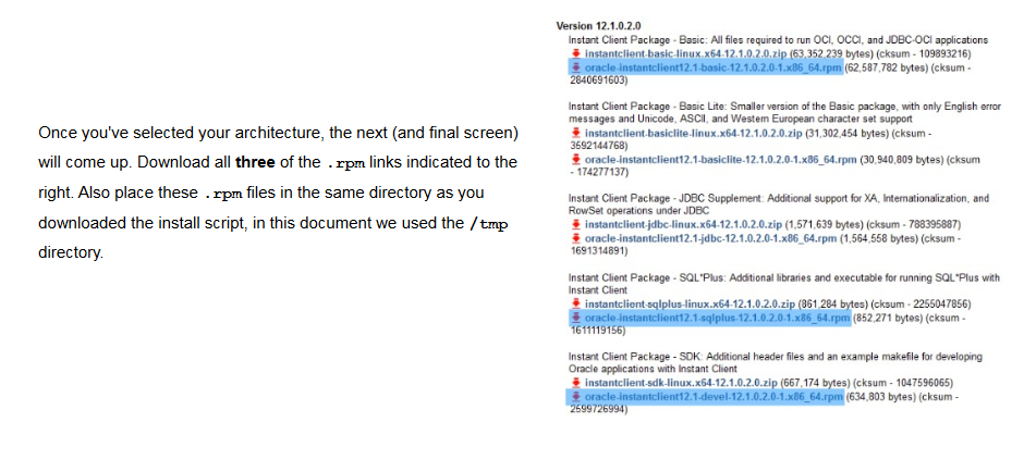

Now based on the results from the previous
uname -i
command, select the proper install for your particular Nagios installation, either 32 bit or 64 bit.
NEXT STEP:
Run The Install Script
Once you've moved the script and all the .rpm files to the same directory, its time to execute the script:
chmod +x oracleinstall.sh
./oracleinstall.sh
