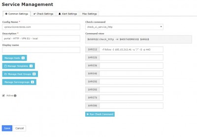

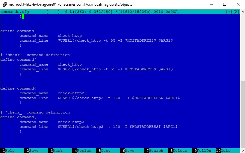

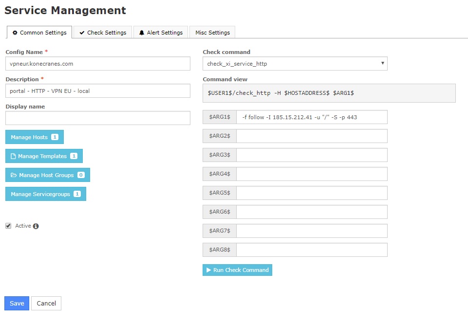

Re: Core returns HTTP 400, where XI returns 302 or 200
your commands do not match
check_http2 should be
$USER1$/check_http -H $HOSTADDRESS$ $ARG1$
but you have
$USER1$/check_http -t 120 -I $HOSTADDRESS$ $ARG1$

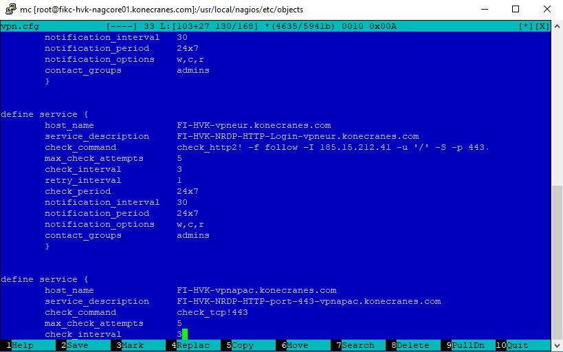

It does matter, this is the command that is going to be executed, have you tested it in the CLI?
/usr/local/nagios/libexec/check_http -t 120 -I 185.15.212.41 -f follow -I 185.15.212.41 -u "/" -S -p 443

scottwilkerson wrote:It does matter, this is the command that is going to be executed, have you tested it in the CLI?
change from -I to -H for check_http2 (copied from XI) just made a difference, irrespective of the delay set.
the problem is that when i execute check_http (stock CORE 4.3.4) in CLI, i get an OK
[root@fikc-hvk-nagcore01 objects]# /usr/local/nagios/libexec/check_http -H vpneur.konecranes.com -f follow -I 185.15.212.41 -u "/" -S -p 443
HTTP OK: HTTP/1.1 200 OK - 7426 bytes in 0.129 second response time |time=0.128775s;;;0.000000 size=7426B;;;0
But CORE GUI with same check_http (stock) shows WARNING
in your Core your check_http service you showed is using
$USER1$/check_http -t 55 -I $HOSTADDRESS$ $ARG1$

scottwilkerson wrote:in your Core your check_http service you showed is using
True :-\
Did not realize while Copy & Pasting command from XI
So -H vs -I must be the difference for the CORE itself?
