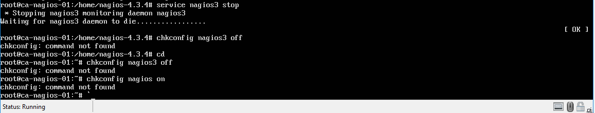

I hope so, I was able to stop the nagios3 service. However, the chkconfig commands were unrecognized. Am I running them correctly? See attached screenshot.
- DevOps Engineer
- Posts: 19396
I forgot this was Ubuntu, you can just skip that
If my service name is now nagios instead of nagios3, how come I still receive an error when restarting using the command you suggested? See attachment.

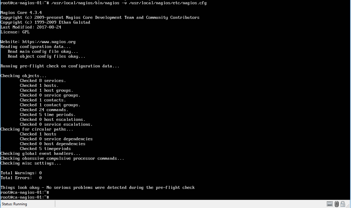

Also, how can I verify the upgrade ran successfully? Using the same help command or is there another pointing to the nagios file rather than nagios3?

you may need to touch that file
Then you should verify your configuration
This was basically a new install and moving configs.
There isn't really anyway to upgrade the old install for several reasons, you didn't know how it was installed, and b the binary was named and located in a completely different location
touch /usr/local/nagios/var/nagios.configtestCode: Select all
/usr/local/nagios/bin/nagios -v /usr/local/nagios/etc/nagios.cfgThere isn't really anyway to upgrade the old install for several reasons, you didn't know how it was installed, and b the binary was named and located in a completely different location
Ok that worked! I'm glad I was able to confirm why I was continuing to see the existing Nagios Core 3.5.1 version. It's because the there are now currently two separate Nagios instances under different configuration folders. I agree to all your points as to why this considered a fresh 4.3.4 install alongside my existing 3.5.1 version.

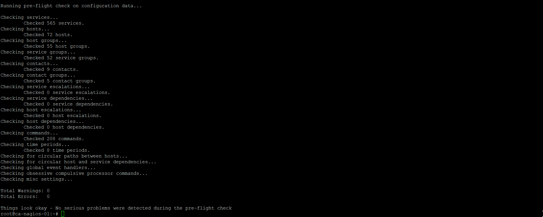

That just leaves the last part, how can I move all my existing configuration from nagios3 folder to the new 4.3.4 directories and wipe out the old 3.5.1 directories? When verifying and comparing both config files with 4.3.4 in my test environment to 3.5.1 in production, it appears there is a lot of config (host files and such) missing. See screenshots of 4.3.4 test environment vs. 3.5.1 production.
Are there a few simple commands I can use to copy over the remaining config from old Nagios to new 4.3.4 Nagios?

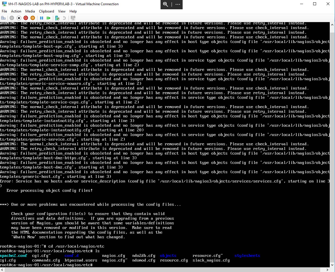

I ran the copy command, when verifying the files in the new directory I now have duplicates of some of the config files (see screenshot). I then run the test config to verify and see multiple "attribute is deprecated" warnings along with an error "service has no hosts and /or service _description. It's pointing to the Nagios3 directory. Will these warnings/errors go away once I remove the old nagios3 config directory?

Wow, you have config files in many locations....
you are going to have to go through all of the linked files and fix all the errors
The lines that are listed as deprecated will need to be removed, and for now I guess I would suggest leaving the items in the /usr/local/lib/nagios3/* directories.
The person who administered this before you sure didn't make things easy on you.
