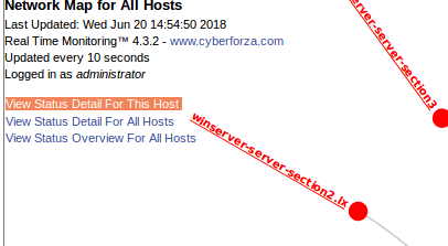

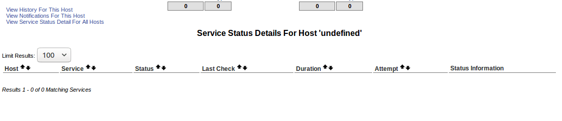

jagannathan wrote:Hello Folks,
-> After login the nagios ui page select map settting option root node after apply, and then view status details for this host option click snap i pasted below.
-> in map view status details for this host option select means it will shown the that particular selected root node details but it shown "undefined",below i pasted the snap.
Now I understand this issue, the "View Status Detail For This Host" always is set to undefined.
I have created a Nagios Core issue here
https://github.com/NagiosEnterprises/na ... issues/539
jagannathan

Hello Folks,
-> For me some suggestion need how to fix this map setting option issue ,
view status detail for this host
view status details for this host option issue

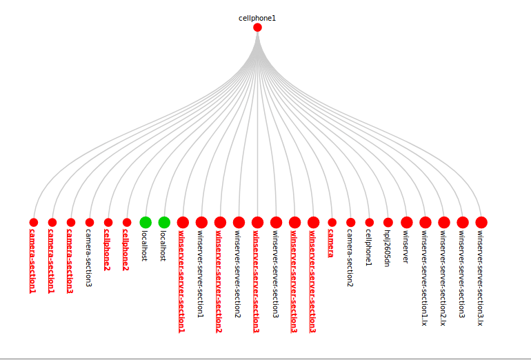

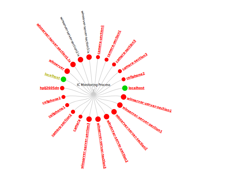

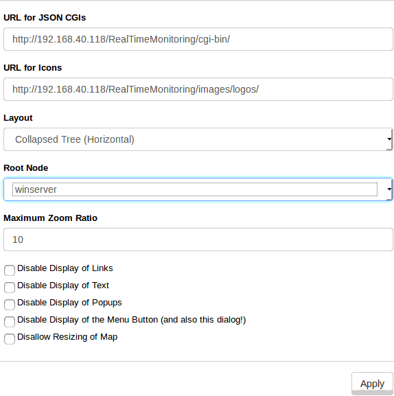

Hello Folks,
> In nagios after login ui page map setting option pop-ups issues :
1. On select the Root node whatever is there in map setting option , i selected winserver that snap pasted below :
Root node in map setting
1.1 After select that particular winserver root node is not showing the map it's always showing 1st selected cellphone1 root node , below i pasted the corresponding snap :
particular root node is not showing in map

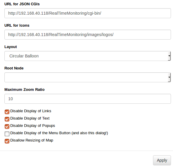

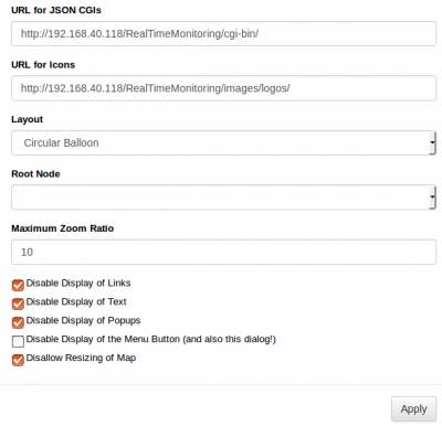

Hello Folks,
-> In nagios after login ui page map setting option pop-ups button's issues :
2. On select the map setting's option button's snap pasted below :
1. Disable Display of Links. , 2. Disable Display of Text. , 3. Disable Display of Popups. , 4. Disallow Resizing of Map
Select the map setting's option button's
2.1 What ever above selected button's not working snap pasted below :
ex : Disallow Resizing of Map : After i enable this button i checked with the map it allow resizing option
Re: Nagios map setting issue 4.3.2
Thanks I have noted these and I will create a Bug Report for them.

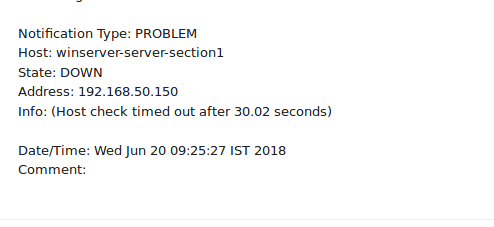

Hello Folks,
-> In nagios send custom host notification time via smtp configuration mail receiving , Comment fields are filled for alerts that are generated automatically at email alerts.
-> How to disable the particular parameter comment fields automatic generated at email alerts.
I don't know what field you are referring to.
What is emailed in alerts depends on what you put in the alert command for specified for the contact.
You can make this command contain anything you wish.

Hello Folks,
-> How to disable the particular parameter comment fields automatic generated at email alerts time.
mail_alerts_issue
mail_alerts_issue
As I mentioned above
scottwilkerson wrote:What is emailed in alerts depends on what you put in the alert command for specified for the contact.
You would want to edit the command that is being used for the host & service notification handlers, and remove what you do not want.
Then restart nagios
