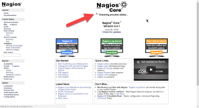

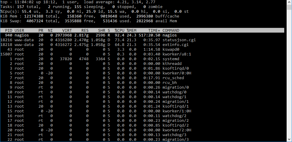

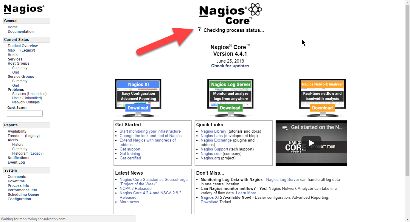

Yes. It varies from 70% to 100%. I have attached a top example. Also the web UI is unresponsive (see attached screen shot as well). It eventually times out to Bad Gateway - it takes about 10-15 minutes, but it eventually gets there.
TOP
TOP
UI
UI

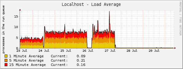

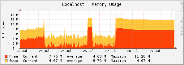

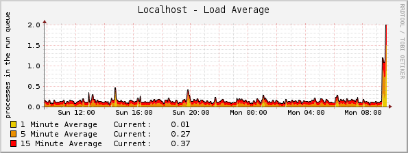

Thanks. That helped get Nagios running. I have attached screen shots of where we are now including performance stats. Response times are still pretty slow on the UI. I don't see nagios in the top results anymore. Looking at top, the CPU is mostly idle and swap memory isn't being used until you try to load a page on the UI. I had top running when I clicked on the Nagios Service Problems link on the left. It took 1m 15s to load the page. I attached a video in real time of the top running so you can see what is happening from that standpoint. Any ideas?
