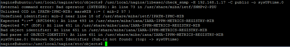

SNMP error.
UndMe
Posts: 14
Joined: Thu Nov 22, 2018 6:40 pm
Re: SNMP error.
Post by UndMe »
scottwilkerson wrote:What operating system are you on? I think you are missing several of the standard MIBs that should have been installed by default when you installed net-snmp
I'm using Ubuntu Server 16.04, the 32-bit version because this machine does not support 64.
Apart from nagios I have not installed any snmp, that may be the problem.
I did not know that the snmp was installed apart from nagios. :?:
Re: SNMP error.
You may need to install snmp with
sudo apt-get install snmp

I have the snmp service installed and I still have the same problem. I have to configure something else?
Re: SNMP error.
For licensing reasons, net-snmp package installs only a small number of MIBs in /usr/share/mibs directory. A large number of standard MIBs can be installed using snmp-mibs-downloader package:
Run this to install the SNMP Downloader and download the MIB files.
    $ sudo apt-get install snmp-mibs-downloader
    $ sudo download-mibs
To have the new MIBs recognized by net-snmp, edit /etc/snmp/snmp.conf file and add the following:
mibs +ALL
That should download and install the missing MIB files on the server.

tgriep wrote:For licensing reasons, net-snmp package installs only a small number of MIBs in /usr/share/mibs directory. A large number of standard MIBs can be installed using snmp-mibs-downloader package:
mibs +ALL
Thank you very much, I have already solved the status of each port of the switch that I am monitoring.
