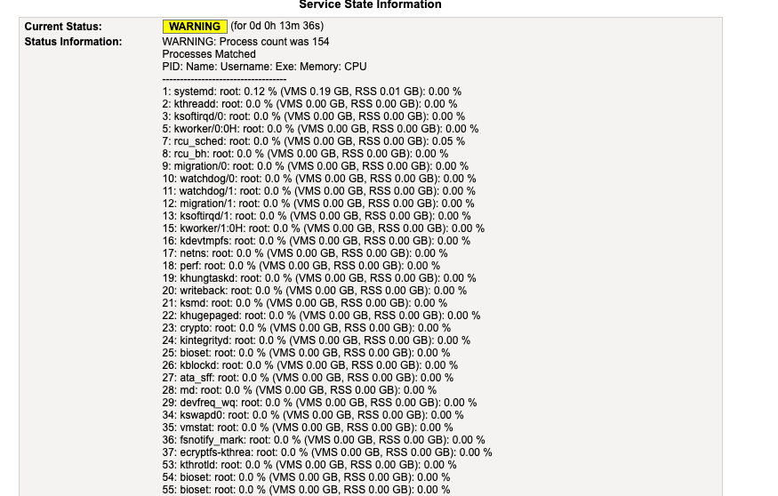

So you mean the process Count?
please find attachment?
No Option to opt-out a particular service?
this is the processes

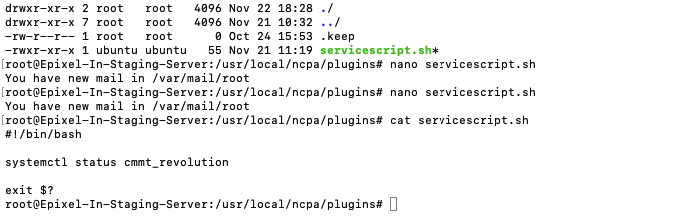

I'm given the execute permission for the file in client-server for the script
Please find the Attachment for a clear view
output while rennung command
script in client machine

I see one issue with your command and one potential issue...
1. You must pass an IP address or a hostname (FQDN) after the '-H' flag... ubuntu@xxx won't work at all. Use:
/usr/local/nagios/libexec/check_ncpa.py -H <ip address of the remote machine> -P 5693 -t <your token> -M 'plugins/servicescript.sh'
Read more on NCPA usage here:
https://www.nagios.org/ncpa/help.php
2. You may not have the permissions for check the status of a service. You may need to add "sudo" in front of the "systemctl status ..." command in your script, and add nagios user to sudoers file on the client. The nagios user should have the permissions to run the systemctl command...
One more thing - you don't need to have "echo $?" at the end of the script. If the service is not running, you will get a non-OK state...
