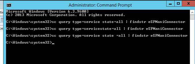

Can you login to the Windows host in question, run the following command as an administrator and post the output here so we can see the service name?
sc query type= service state= all | findstr eSPNaniConnector

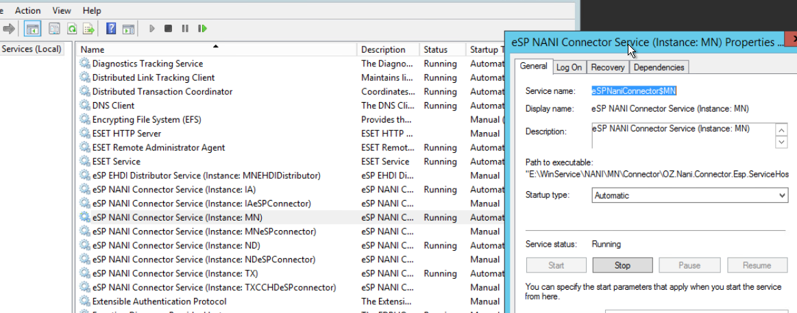

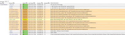

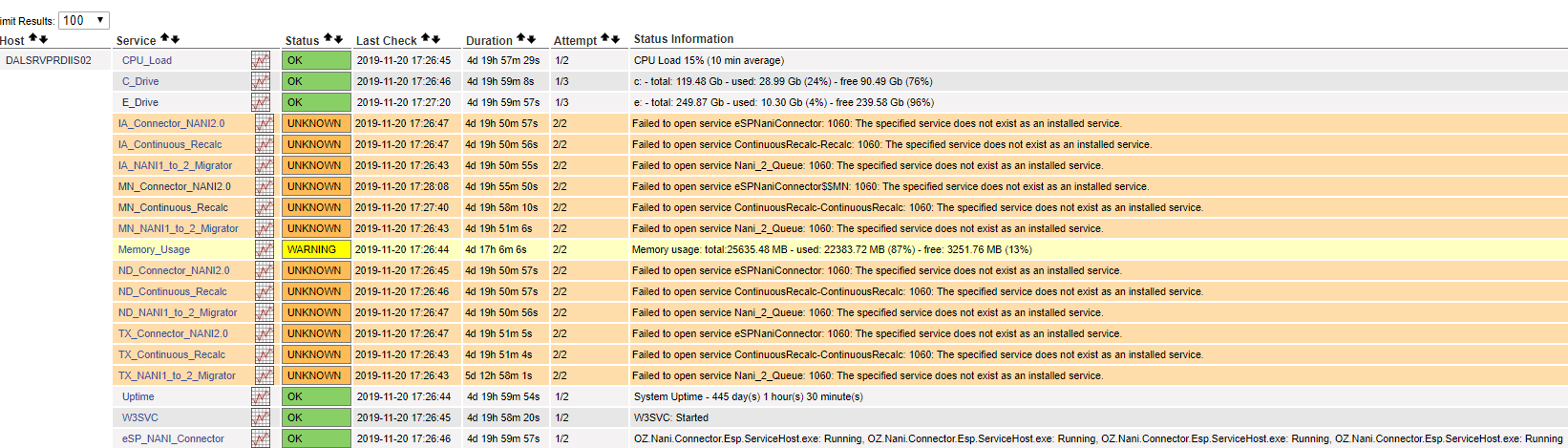

So the memory usage and what not work fine using the check_nt command, which i think is weird.
I have uploaded screenshots

I have already done that before and it did not work, however executing it from the terminal like so(below) and it brings back data.
./check_nt -v SERVICESTATE-d SHOWALL -l eSPNaniConnector\$MNeSPConnector -p 12489
but if running it with the $$ and no port it tells me cant be found, and or unable to communicate on port 1248
