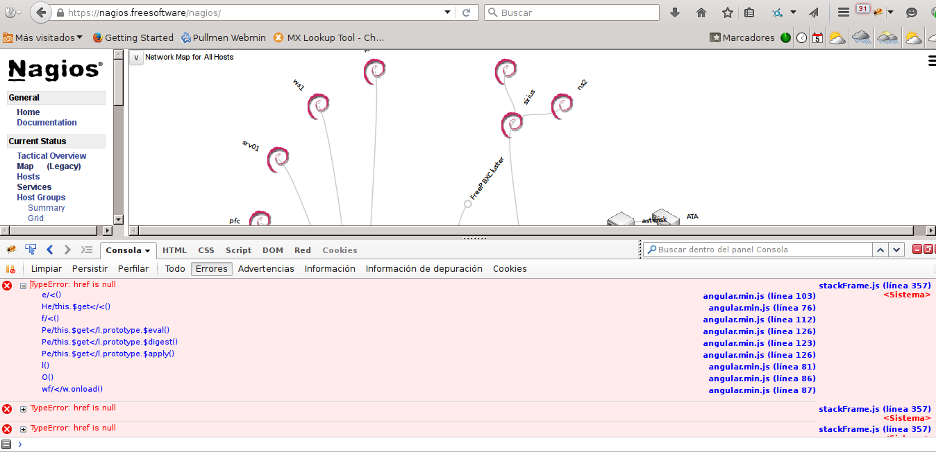

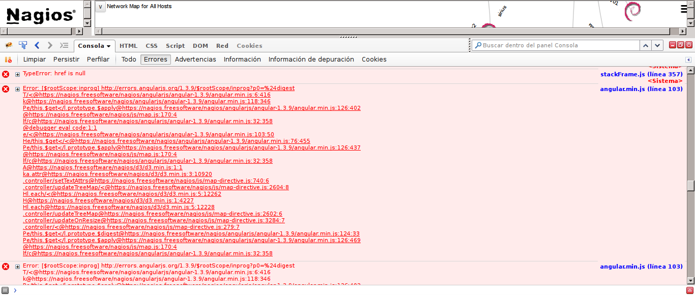

DanielB wrote:Thanks for sharing this information with the developers. Along the same line, I have installed Firebug on the Windows Server 2012 where I also have this problem with the information shown on the network map and I can see the same errors shown on Debian Jessie. Attached screenshot.
So we probably have something here. Especially if you do not see these errors in the tests where the information was displayed correctly. Can you confirm this?

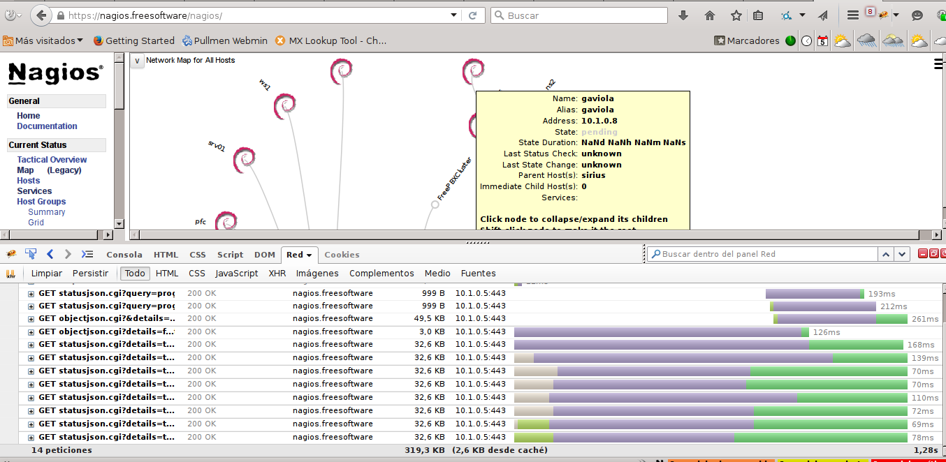

I have reviewed the Network tab and I see entries for statusjson.cgi but I don't know what is exactly what I should look. Maybe you can help me here. I attach a screenshot.
Moreover I think now I see other different errors to that I showed earlier in the Firebug Console. I'm not sure if this has to do with to have upgraded to Iceweasel 41.0. I attach a screenshot.
Click on one of the statusjson.cgi lines to expand it. Then select the "Response" tab. Copy the contents of that tab and paste it into a message here.

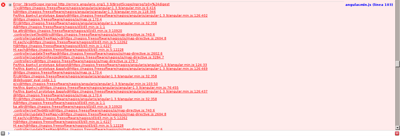

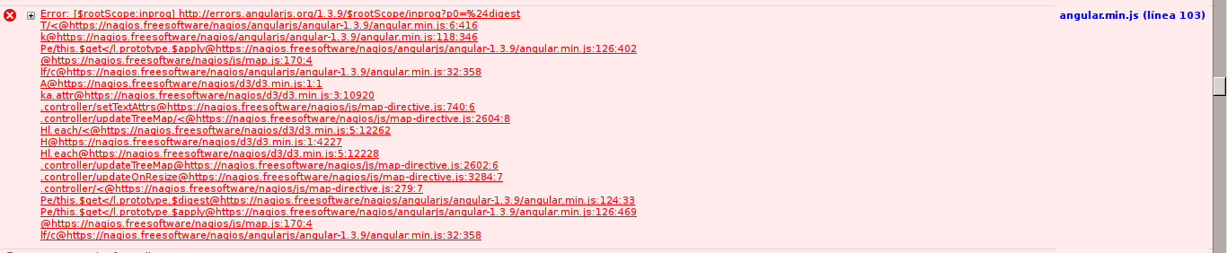

I'm not sure if I've understood this. The majority of the entries (I think they're 324 errors so far because the number displayed besides the Firebug icon that is on the navigation bar of Iceweasel) I see in Console->Errors seems to say the same when I compare the number of the lines (I do not see columns numbers). But I think the errors shown there are independent of the URLs selected in the "Network" tab, right?
I've seen a lot of errors of "Error1" type (see screenshot) and only a few of Error2, Error3 and Error4 type (see screenshots).
Error 1
Error 1
Error 2
Error 2
NOTE: Error3 and Error4 screenshots are placed in the next message as there is a limitation of number of attachments.

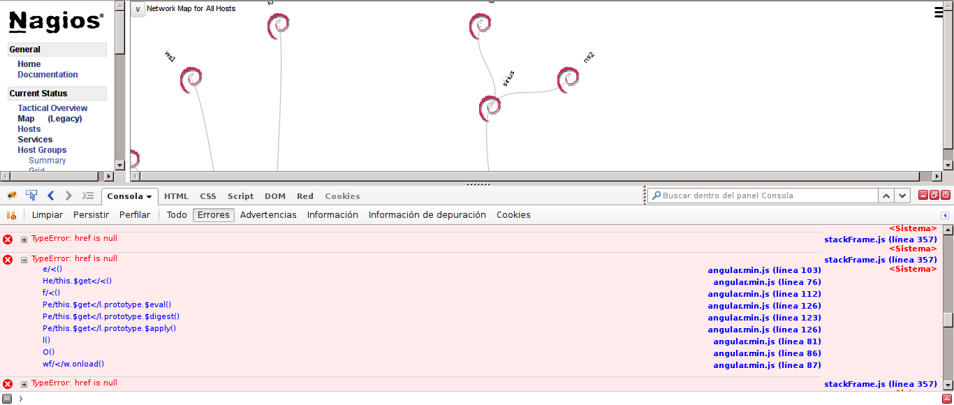

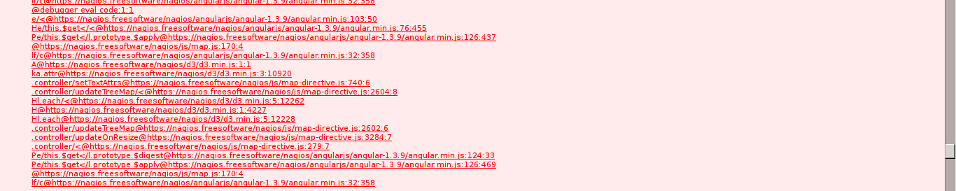

Error 3 / Part1 (It is an error with several lines and it does not fit in a single screenshot)
Error 3 / Part2
Error 3 / Part2
Error 4
Error 4
