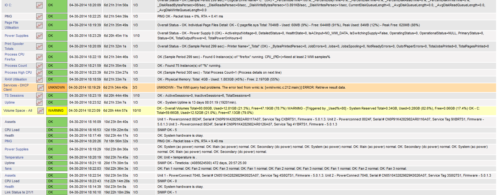

I have attached the screenshot of the web interface. It refreshes but nothing updates. The last update is still 30 April. Not sure what is broken.
I have updated/installed some plugins so I don't see "Return Code 127" error anymore in /var/log/messages.
I figured out that nagios.log file is not updating the status is same from yesterday.
Also it doesnt matter if the nagios service is stopped or started- the output on web remains same.
