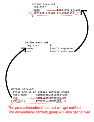

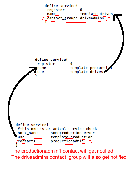

I took a few minutes to give a couple examples that I believe outline what you are running into. Maybe the arrows and diagramming will help (there are bits left out for clarity; the bottom service definition would have a 'name' line at least).
In the first example, you end up with both productionadmin1 and the contact group driveadmins getting notified when the bottom service goes critical.
Service Contact Inheritance Example 1

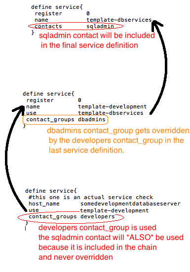

In the second example, the developers group gets notified, and the sqladmin contact gets notified. The dbadmins contact group does NOT get notified because it is overidden.
Service Contact Inheritance Example 2b
Edit: Fixed error in 2nd example image.
