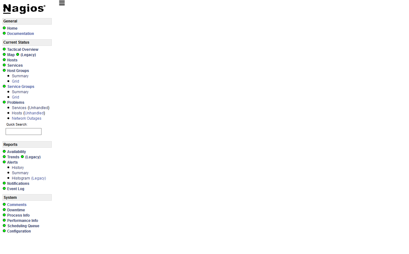

Ok the Legacy Trends and Map are working. But the non-Legacy ones don't show anything except the hamburger link.

Can you screen capture the error and post it here so we can see it?
Are there any errors in the Apache error logs when you click on those links?
If so, can you post them?

I don't see anything showing up in the apache error logs. I have uploaded a screenshot though.

Re: Nagios 4.1.1 on Ubuntu 14.04
I found that there are possible issues displaying the Map and Trends report in the server's locale is not set to US.
You can either set the server's locale to US or update to Core 4.1.2-Pre1 which fixed that issue.
Below is the link to Core 4.1.2-Pre1 if you want to download and compile that.
https://github.com/NagiosEnterprises/na ... 4.1.2-Pre1

Are there downsides to installing the pre-release? With the legacy functions working, I am not pressed to upgrade until final release.
Bugs find me
Posts: 13589
I don't see any. You can always upgrade when the "final" release is out.
