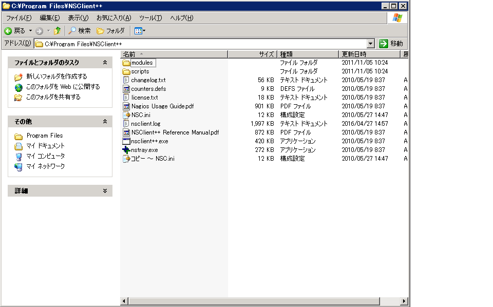

I log in to remote host C
I move to C:\"Program Files"\NSClient++
I want to carry out "check_nrpe.exe", but there is no "check_nrpe.exe". What can I do?
I attach screenshot in C:\"Program Files"\NSClient++\.
If there is a thing substituting for "check_nrpe.exe", please tell me.
By the way, I send the result of server A and server B.
