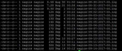

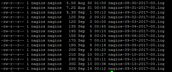

I have hit tail on the latest log and Most of them are Max concurrent checks & Dormant child reaped errors and My doubt is does changing to debug_level=0 is causing log to grow ?
When i check database tables in "/var/lib/mysql/nagios" the "nagios_logentries.MYD" is taking 117GB, attaching the screen shot of files that taking more space and Does this making it freeze frequently and its happening more often when we add anything new to cfg files and do "Service nagios reload" than Restart.
Max concurrent service checks (319) has been reached. Nudging MDX812:Router by 6 seconds...
Max concurrent service checks (319) has been reached. Nudging MDX357:M7014 Encoder Storage by 15 seconds...
Max concurrent service checks (319) has been reached. Nudging MDX599:X-310 Relay 3 State by 11 seconds...

tgriep - This was the message i got in my daily mail "/var/mail/root"
Is this is what making the log to grow since logrotate is not working ?

Sorry for the late response tgriep .So what can be the reason? Its just eating up my disk day by day. Could you please help?
