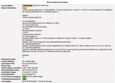

But I'm not getting any output. I have attached screenshot of the result.

Re: Postfix for nagios email notification alerts problem
It looks like there is a missing option in the command an incorrect settings.
Can you post the full configuration setting for that service so we can view it?
Siddharth Hegde
Posts: 70
Joined: Mon Aug 07, 2017 4:19 am
Post by Siddharth Hegde »
Hi @tgriep,
Please find the attached configuration files
nrpe.cfg
/usr/local/nagios/etc/
(12.36 KiB) Downloaded 552 times
nagioshost.cfg
/usr/local/nagios/etc/servers/
(2.08 KiB) Downloaded 574 times
Your command in the nrpe.cfg file
command[check_usolved_disks]=/usr/bin/php /usr/local/nagios/libexec/check_usolved_disks.php -w 90 -c 95
Is missing some of the required options.
You heed to specify the hostaddress, the community string and the snmp version
-H HOSTADDRESS -C COMMUNITY -V SNMPVERSION
So, change your command in the nrpe.cfg file to the following example, replacing the options with valid entries.
command[check_usolved_disks]=/usr/bin/php /usr/local/nagios/libexec/check_usolved_disks.php -H HOSTADDRESS -C COMMUNITY -V SNMPVERSION -w 90 -c 95
And that should work for you.
