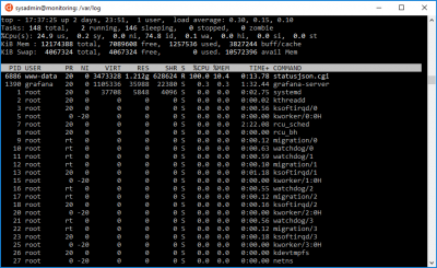

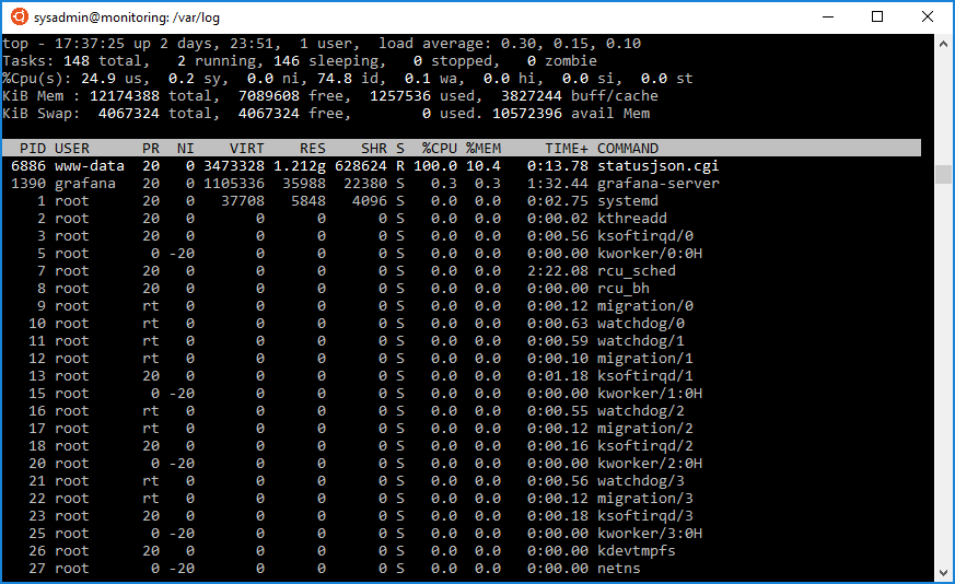

consulvation wrote:I had top running when I clicked on the Nagios Service Problems link on the left. It took 1m 15s to load the page.
Can you do this again and after a few seconds of waiting take a screen capture of the top window?

Post by consulvation »
Here you go...
Top
Top
Re: Nagios process at 100% CPU, system is crawling
Looks like the load has come down considerably, and the nagios process is not in the list of top processes.
The one item listed is a call the the statusjson.cgi which can be intensive if the call is for historical data

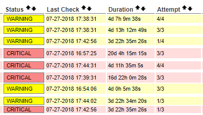

Also, I should add that it looks like Nagios is stuck in the past. Looking at the status, the last checks were from 4 days ago. Looking at the scheduling queue, it's from 4 days ago.

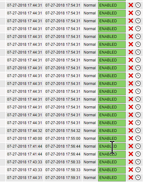

Their was a bug in 4.4.1 that duplicated comments etc, which could have been causing your issue
